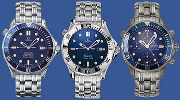

What different Seamaster watches are available?
OMEGA currently makes several models of Seamaster watches, with numerous sub variations of color, bracelet, movement, and casing sizes. As of early 2004, the main Seamaster models in production are:
Recently retired Seamaster models include:
For details on these limited editions and several rare and special editions of the recent Seamaster models. See the Seamaster Photo Gallery for more details on these.

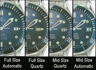

How can I tell the Seamaster Pro fullsize, midsize, automatic and quartz models apart?
The numerous variations in the Seamaster Professional Diver models can be hard to tell apart. The features on the two men's sizes available on the Seamaster Professional Diver are both scaled to not appear significantly different. The mid-size even uses a slightly narrower bracelet (18mm instead of 20mm) and a somewhat smaller clasp to keep the whole watch looking the same.
So, how can you tell them apart? First, there is a visual difference in the position of the date window between the quartz and automatic movements. The date window on the quartz movement is a millimeter or so closer to the center of the dial. Second, the smaller case on the mid size means the right edge of the date window will be about 1.5 millimeters closer to the edge of the dial than it is on the full size case.
Combined, these two factors give a different position of the date window on each of the four case size/movement variations on this watch.
The easiest part is to tell the movement. The automatic models have four lines of text on the lower half of the dial -- including the word CHRONOMETER as the third line. The quartz models have only three, lacking the word CHRONOMETER.
To tell the case sizes apart, look at the marker at the 3 o'clock position. The mid size have little to no room for a marker to the right of the date window. But the full size have room for a moderate to large marker.

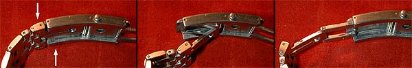

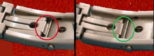

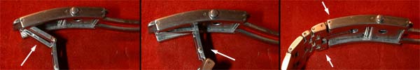

What is the Bracelet Diver's Extension for and how do I use it?
Opening the diver's extension: 1) press on bracelet as shown to pop the extension open, 2 & 3) opening it fully.
Closing the extension: 1) critical first step of inserting flange at steep angle so it goes under the crossbar,
2) then fold the rest into place, 3) a little pressure and it snaps shut
The diver's extension is a portion of the bracelet clasp that, when popped open, extends the length of the bracelet by 3.1 centimeters (about 1.25 inches). This allows it to instantly change from being sized to fit on your bare wrist to the larger size needed to fit over the sleeve of a wetsuit. While interesting, this is a feature that is of virtually no use to anyone who is not a wetsuit diver. Though it could be used to wear the watch on the outside of an elastic jacket cuff in cold weather.
One critical point to note when operating the diver's extension is to ensure you have closed it properly when done. The small flange on the extension must fit under the crossbar. Failure to close it properly can interfere with the main bracelet clasp--causing the clasp to pop open unexpectedly while you are wearing the watch.

Hey, isn't there a James Bond Seamaster Pro with black dial and bezel?
No. while many models of the OMEGA Seamaster have been made with black dials and black bezels, OMEGA confirms that the skeleton-hand version of the Seamaster Professional -- including both the Professional Diver and Chronograph (commonly known as the 'James Bond' versions, introduced 1993 and still available in 2000) have never been made with either a black dial or a black bezel.
The prior versions of the Seamaster Professional (1988-1992, known as the 'pre-Bond' versions) did have black dials and black bezels. It resembles the 1993-2000 version enough that the two are sometimes confused.
Later versions, starting with the Seamaster GMT (1998) and Seamaster 'America's Cup' Limited Edition (1999) included black dials with steel or white gold bezels. The black dial resurgence continued with the additional Seamaster Pro models introduced in the 2000 model line including many with black dials accompanied by black, steel, or white gold bezels.
Yet none of the editions that have had black dials or black bezels have had the skeleton hands. So if you see a skeleton hand Seamaster Professional which appears to have a black dial or bezel, then there are only two explanations: you are misperceiving the color, or the watch is one of the counterfeit versions that were made in black -- despite that being an inaccurate reproduction of the original watch. For more detail on counterfeit watches, see the section on Fake and Counterfeit Watches and the Rogues Gallery of Fakes.
Misperceiving the color is not unusual. People can easily mistake the dark navy blue on the 'James Bond' Seamaster Professional Diver for black. This mistake occurs from several simple causes:
