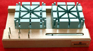

If you really want to do it yourself, get the right tools. One very good source is Frei & Borel, who sells professional bracelet sizing tools like the one shown below.
Bergeon Bracelet Tools Set [Derek Ziglar]

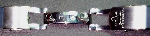

OMEGA deployant clasp for standard watch straps
Note that the watch is facing the opposite direction in the second photo.
[Robert Jan / omega-addict.com]
OMEGA offers the 94531603025 (16mm only) steel deployant clasp for use on normal tang-buckle type straps. It is similar in function to the generic deployant clasps sold by various Internet dealers in that the strap tail goes on the outside. Essentially it replaces the tang-buckle with a more elaborate mechanism, but without changing the way the strap goes around your wrist.
While it works with normal straps, it is important to note that this design has limitations. People with smaller wrists--those who would normally wear their strap buckled into the innermost two holes--may find this deployant akward. When adjusted to the smaller end of its range, the inner metal piece tends to go up the side of your wrist. The alternative style below does not have this limitation, because on it, the clasp folds the opposite direction, allowing the inner metal piece to point the other way and stay across the flat underside of your wrist.

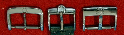

Can I get an OMEGA signed tang buckle without having to buy an OMEGA strap?
OMEGA will sell you any of their deployant, foldover, and rubber strap diver's clasps directly. But they do not sell tang buckles separately to the consumer. If you contact OMEGA Customer Service directly or go through the retail end of an authorized OMEGA dealer, the answer will be "no, you must buy a genuine OMEGA strap to receive the OMEGA signed tang buckle."
OMEGA-signed buckles: [left] from modern OMEGA dress strap, [center] vintage, [right] from modern OMEGA sport strap
Fortunately, there are three main alternative sources. The first is that you may already have what you need! Many people fail to realize that strap buckles need not be thrown away when the strap wears out. Buckles are attached to the strap using spring pins just like how the strap attaches to the watch. So the signed logo buckles on your genuine brand-name strap are easily detached when the strap is no longer needed and moved to most any other strap of the same buckle width.
Second, dealers in used watches occasionally have preowned and vintage buckles left over from watches traded in with worn or surplus straps. Try checking with local used watch dealers and watch repair shops. If you have an ongoing relationship with one of these shops, let them know what you are looking for.
And finally, there is an indirect way to order them from OMEGA. The secret is that OMEGA does sell tang buckles separately--but only as a replacement part through their commerical parts channels. So to obtain one, you need to have a watch repair facility or dealer's repair department order it for you. However be forewarned that ordering such parts is often difficult. Not only are part numbers difficult to track down, but few businesses have the time and patience to go through the effort necessary to find and order such unusual, seldom ordered and low cost/profit parts. Usually it is worth the difference to buy at least one genuine OMEGA strap, then keep the signed buckle and move it to other straps after the original strap wears out.
A complete part number list is not available anywhere outside OMEGA themselves. To give you a starting point in your search, OMEGA part reference 94511602 (16mm) and 94511802 (18mm) identify the steel versions of the rightmost buckle in the photo above. Similar versions exist in brushed finish steel (for the modern Dynamic series) and plated yellow gold. Note that this particular buckle design is specifically for a sport strap, requiring a 2mm tongue slot in the strap. A 1mm wide tongue as seen on the left and center buckles is more typical. So cross-check your intended strap and all part numbers and descriptions thoroughly before ordering to avoid disappointment.

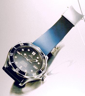

Seamaster Pro 'Bond' on the original optional flat blue rubber strap [left photo: OMEGA, right photo: Steve Biczak]
The flat blue rubber strap available for the Seamaster Pro Diver. It is a highly durable flat rubber strap in a blue that compliments the Seamaster Professional 'Bond.' It uses the Seamaster Professional diver's deployant clasp and should be available in both 18 and 20 mm widths. See below for prices and part numbers. This strap has been available since the mid-1990's.

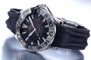

Seamaster GMT model 2834.50.00 on its standard black rubber strap [OMEGA]
The ridged black Seamaster GMT rubber strap with the Seamaster Professional diver's deployant clasp. May not be available in an 18mm size, since the Seamaster GMT it is made for does not come in a mid-size. This strap has been available since the 1998 introduction of the Seamaster GMT. See below for prices and part numbers.

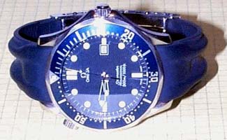

Right: Seamaster Pro 'Bond' on the new blue rubber strap [Ron Z]
The ridged blue rubber strap comes on the Seamaster Pro Titanium model 2991.80.93. It is a highly durable, thick and ridged rubber strap in a blue -- apparently identical to the black GMT rubber strap except for the color. Uses the Seamaster Professional diver's deployant clasp.
This ridged blue rubber strap is VERY popular with Seamaster Pro 'Bond' owners, though many have had difficulty ordering it. May not be available in an 18mm version, because the Seamaster Titanium it is made for is not available in the mid-size model. See below for prices and part numbers. This strap has been available since the 1999 introduction of the Seamaster Titanium.
