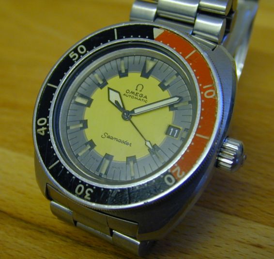

They are great watches & quite rare. But they do pup up now & then on eBay for considerably less than Cliff claims is the market price, ( See link below ).
There is little Info about these on the internet. I wonder which dial came first. The dial WITH depth rating as shown in Jeff's original post
