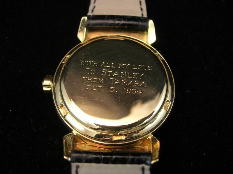

This striking 1953 Seamaster Chronometer was sold in the US as the "Ultima" and in the rest of the world as the "Deluxe". In 18k gold, in an era just as the top of the line Constellation arrived (introduced in 1952 and always chronometers), this was one of the best Omegas available.
Turn it over:
Doesn't bother me a bit -- how about you?
