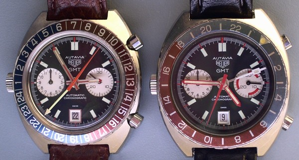

The following is my first draft of a comparison of the Autavia Automatic GMTs. I would welcome any comments, and will post a message when it "goes final" (not that anything is ever "final" on a website).
Comparison of Autavia GMTs --
Reference 1163 GMT (left) and 11630 GMT (right)
Reference 1163 GMT
Reference 11630 GMT
Year Introduced
1970
1972
- Bezel
numbers 1 through 24
even numbers only -- 2 thorugh 22, with triangle for 24 (with luminous dot)
Inner Bezel (between dial and crystal)
polished steel (shiny) tension ring
matte black support ring (flange)
- Crystal
plastic (domed)
mineral(flat)
Registers
white
white, with red accent on 30-minute register

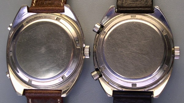

- Case-Back
shallow
shallow
- Pushers
fully visible from front, and partially obstructed from back
fully visible from back, and partially obstructed from front
- Thickness (top of bezel to back of case)
13.0 mm
15.0 mm
- Hands
brushed steel, with red inserts and tips, and narrow luminous inserts; GMT hand has pointed tip triangular)
red edges and wide luminous inserts; GMT hand has rectangle neare end
Movement
Cal 11 GMT
Cal 14
