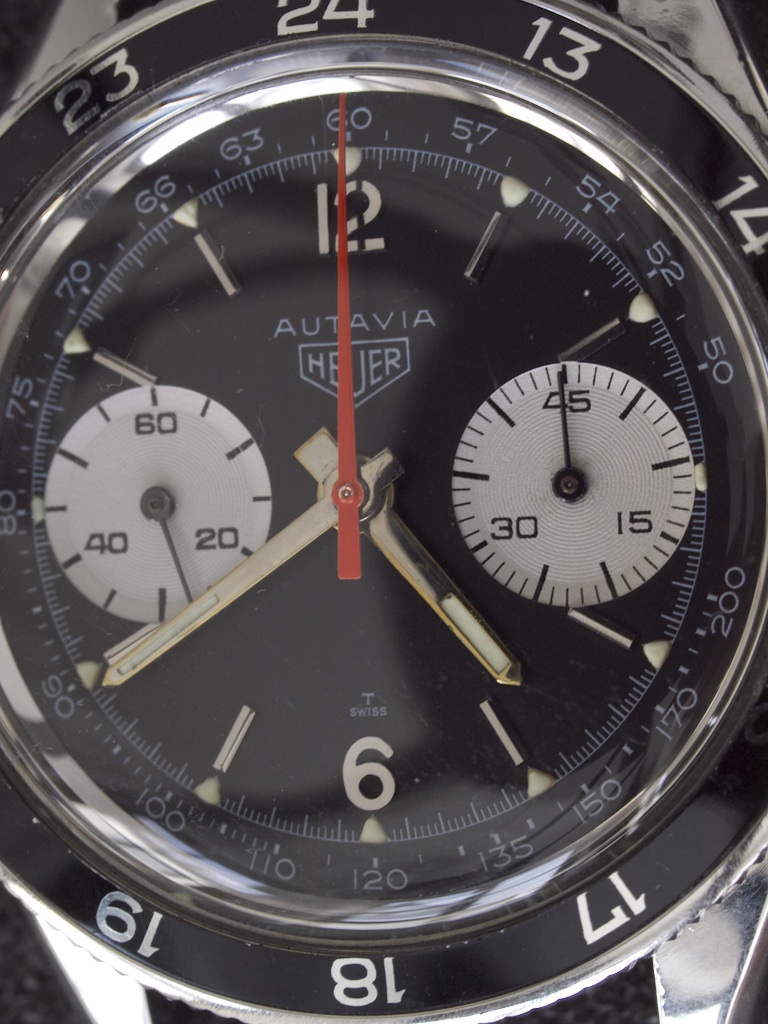

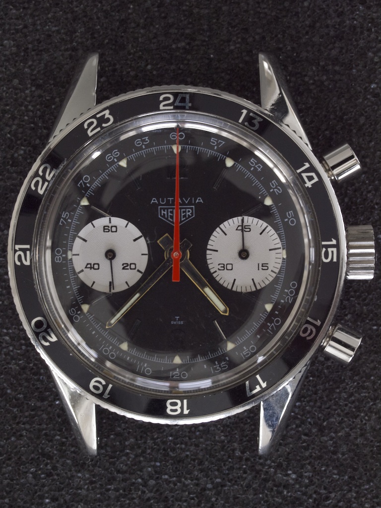

Hi Mick - great shots and now we can see yours in all its glory. Firstly, I would agree that this dial with tachy scale and raised hour markers has that little extra compared with the standard 3646 Autavia of similar generation. Of course the earlier versions had some of these details and that’s what makes them special too. The bezel is most interesting. Comparing it to mine, the bezel itself is identical however the insert is the interesting bit. I have never seen one like it and I am hoping that the Master in the US or maybe other well travelled collectors may be able to give us some more information on this. I do feel that the single number i.e. hour bezel is the best fit for this watch. It’s simpler than the minute bezel and would therefore sit better with all that going on on the dial.
I look forward to reading more from the worlds Heuer experts.
regards
Paul www.heuerworld.com

: I bought the watch because its face is more lively than the usual
: cal. 92 Autavias, but yet looks consistent and very appealing,
: especially the applied markers and digits (see below).
: The main hands have the visually correct size, and are shorter than
: those of the other 3646 Autavias. Could anyone confirm or
: decline the story of the apparently correct but too long hands
: seen on the other "interesting Autavia"?
: Certainly the chrono second hand was replaced. I'm searching for a
: white hand as seen on the usual cal. 92 Autavias, but shorter
: exactly touching or just passing over the minute/seconds
: chapter.

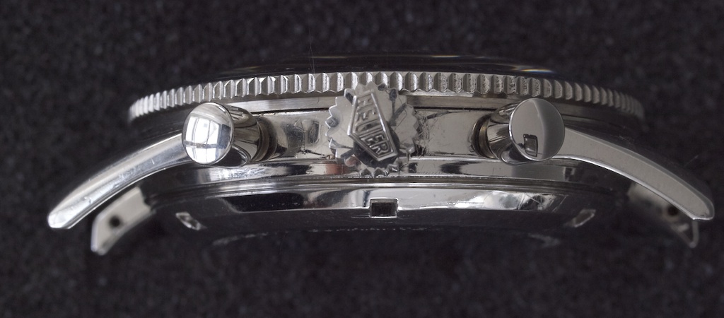

: I'm not sure about the bezel. The original bezel could be
: substituted easily, e.g. by a Rolex part. I did never see this
: kind of bezel on a Heuer. Speaking of typography, the fancy
: "3" does not look correct (other bezels show a round
: "3"), the other digits, namely the "4", look
: ok. Did anyone see this kind of bezel (see the side views below)
: on a Heuer or another type of watch?
: The 13 to 24 hours display may be useful, but how is the rotating
: (without click) bezel used? Pseudo GMT?
: The crown seems to be too thick.
: This slightly tilted view shows the gorgeous applied markers and
: digits.

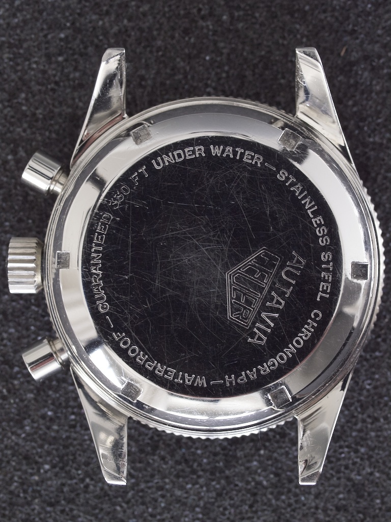

: No surprises on the back.

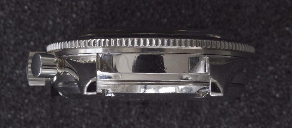

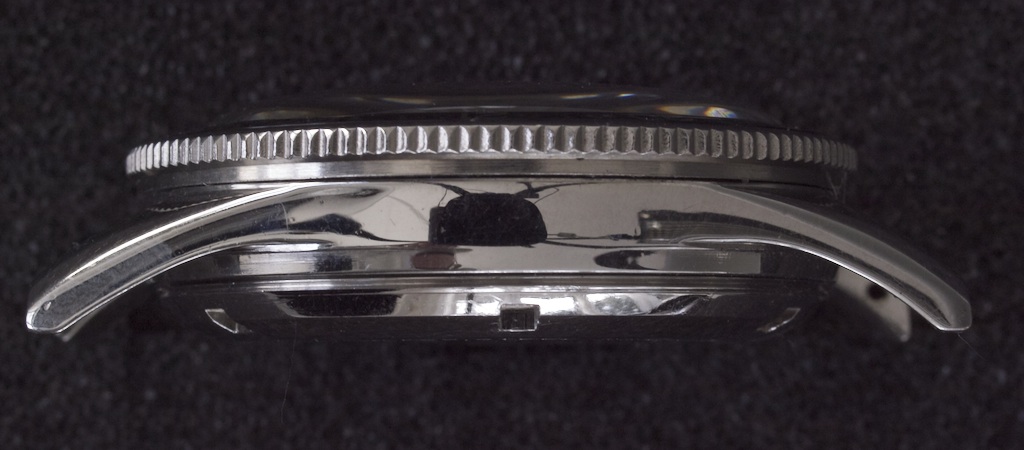

: The side views reveal more characteristics of the rotating bezel.
: I really like this elegantly curved lines of the middle part and
: the trapezoidal profile of the case of these first Autavias.
: The serial number is in the 84XXX area. The movement is a cal. 92
: correctly signed "Heuer-Leonidas".
