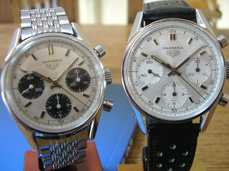

As time progressed though, the brushing went away entirely and the dials became more of an enamel white/off-white finish:

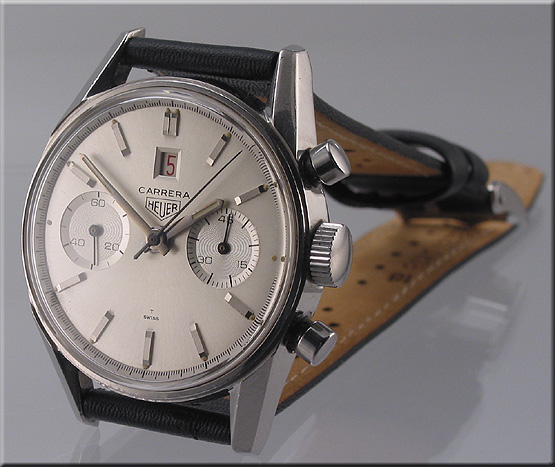

Interestingly, however, when the "main" series of Carreras tended to be this more enamel finish, the Dato 45s came along and were strongly silver. S Dato 45s should always have silver, rather than whitish, dials:
Then, when the second execution dials with marker inserts come along, we're back to more silvery dials:
Note that the brushed finish is now evident again. If you look closely, you'll also see that the second layer of the dial "sandwich" is distinctly white, giving the effect of white registers on a silver dial:
Earlier watches had a same coloured second layer, so it was always silver on silver or off-white on off-white - these late watches could almost be called contrast registers, as the white is clearly different from the surrounding silver. In fact, I wouldn't be surprised if the second layer of these nominally silver watches is exactly the same as that which would be used in the NSTs etc:
