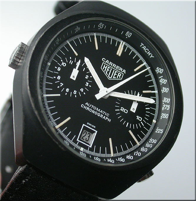

: 1. Did they have lume on the dials? Mine doesn’t have any and it
: seems odd to me that there is nothing. From the photos online
: that I have seen its hard to tell if they do or not.
Yes, they had lume "sticks" like the PVD Monaco, that ran the entire length of the white hour marker on the dial. They are notoriously prone to breaking and pretty much every dial you see has lost them to one extent or another.
Look at the example above and you see them intact at 3, 4, 5 and 7, partial at 10, 11, 12, 1 and 2 and missing entirely at 8 and 9. Yours is following the pattern of 8 and 9! Arguably, totally missing actually looks better than partial sticks and it's very rare to see one intact:
