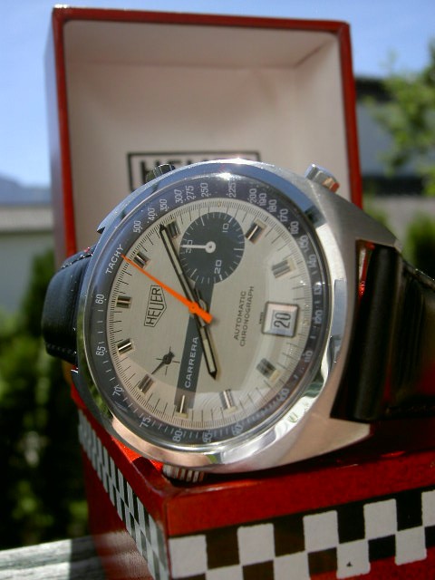

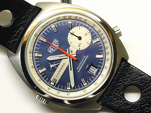

-Ah, the dial... Well, the dials we know of for the 1553 are quite distinctive:
The Carrera "bar" is something of a signature for the model and is present on all of the genuine examples I've seen. And those two colourways (blue and silver) are equally the only ones we can validate. We have seen a black one floated around a couple of times:

I have never seen one without the bar, but I do know that Heuer did produce some Call 15 watches off brand, and some of those do indeed have black dials. This Bulova "Autavia" springs to mind:
but there are other, more off-brand, examples too. The Heuer examples were marked "Swiss" above the date window rather than the "Swiss Made" of the watch in question, and not marked for tritium. So I suspect this one started life as something else and the dial has been refinished to make it a Heuer Carrera.
We can date them to an extent from the serial number, but only by comparison with other serials and it's not all that scientific - the off-brand ones usually take from the same case batches as Heuer-marked watches though, so it doesn't always help as much as it could.
