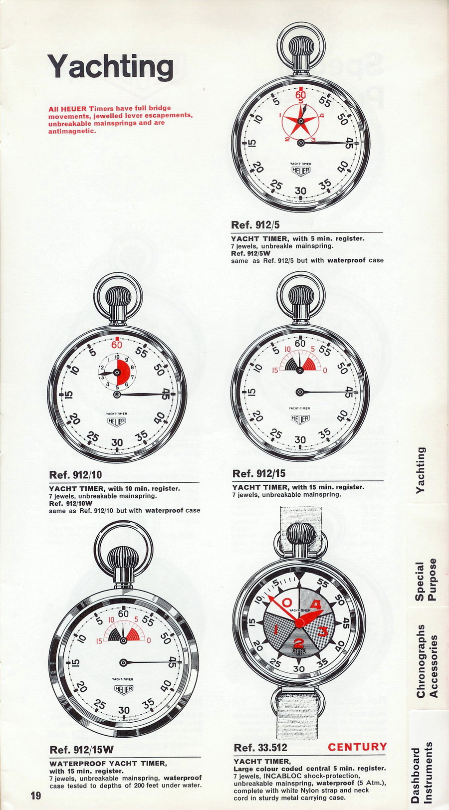

Hi Samamtha,
It's a yachting stopwatch from the 1960's - you can see it below in the 1962 catalogue. Although the one in the catalogue has a 10 min sub register, whereas yours has a 5 minute.
I believe different minute countdowns were used for different types of yacht racing. I'm no yachting expert - but they countdown as when a yacht race begins there is a sequence - ie. there is a horn that sounds 5 mins to go till the start of the race, so the yachts have to be tacked so that on the second 'go' horn, they are perfectly positioned right on the start line. Each type of race has different sequences.
Was your grandad a yachtsman?
http://www.onthedash.com/Guide/_Catalogs/1963_Catalog/Page19.jpg
Cheers
Stewart
