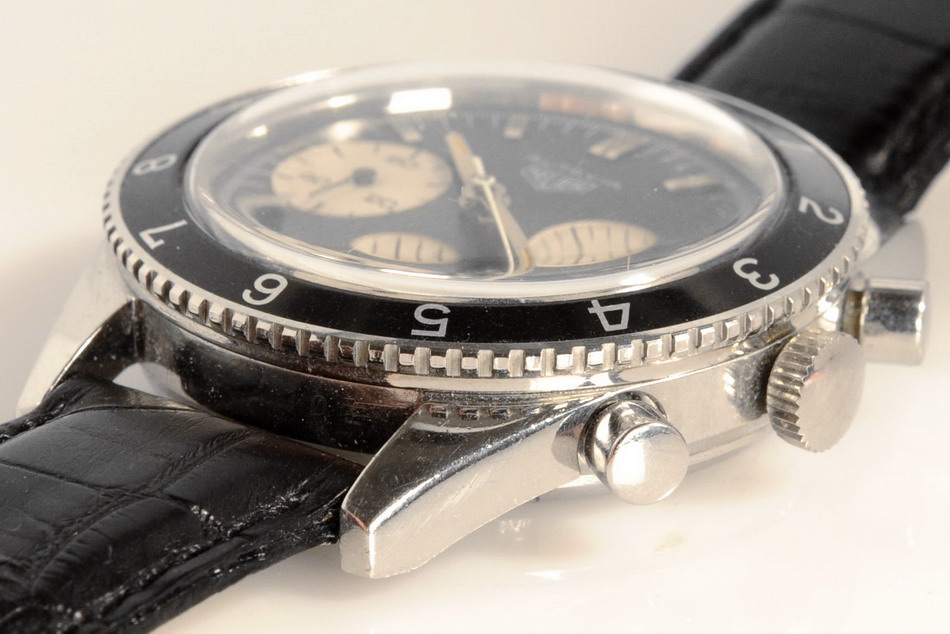

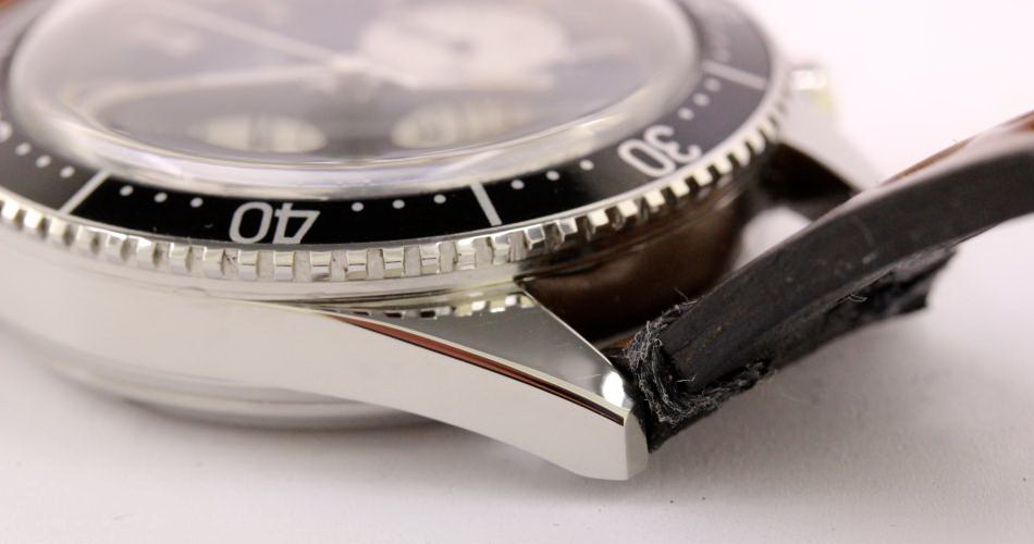

One thing seems certain -- this is not what we call a "Transitional" case.
Lugs on Transitional case have two primary surfaces -- top and side. See the two photos below.
The Autavia being sold by Phillips seems to have the "third" surface between the top surface and the side surface. I believe that this third surface would be called a "chamfer" or a "bevel". Whatever it is called, it is a third surface, that connects the two that are perpendicular to each other (the top and the side).
So this seems to be the usual first execution screw-back case.
