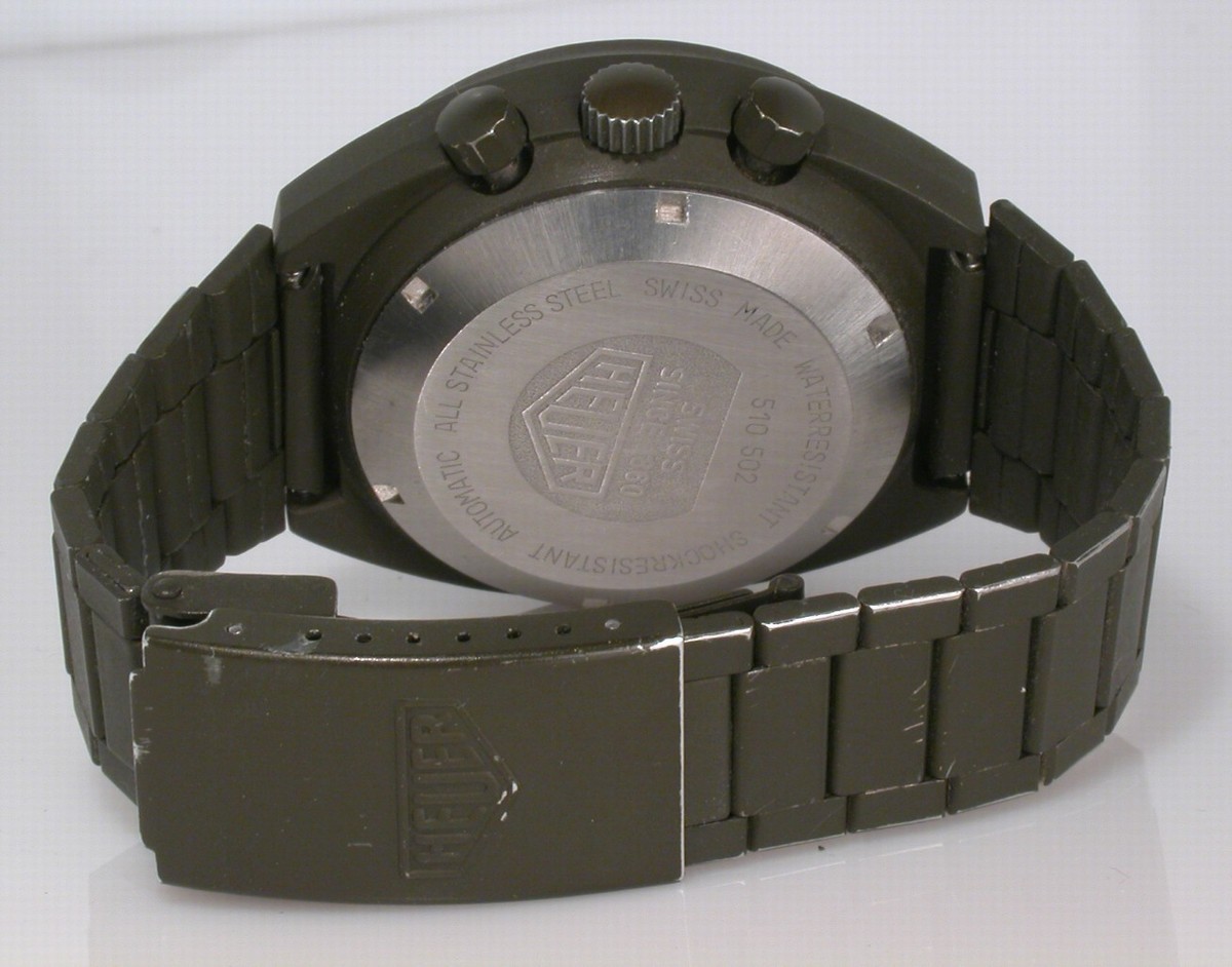

TACHY SCALE: A number of Heuers also have a tachy scale. However, when it is just a tachy scale (and not combined with other scales as an on the Montreal and Monza), they use the wording "Tachy" rather than the full "Tachymetre" on this watch. The 1000 series watches are an exception:
http://www.onthedash.com/Guide/_Chronographs/86.1000_Series/
But the tachy scale here doesn't match any of those on the 1000 series watches.

CASEBACK: A similar looking back to some Heuers, although many casebacks look similar anyway. The wording on this one differs from contemporary Heuer casebacks:
http://www.onthedash.com/Guide/_Chronographs/77.Monza/Modena/15ModenaBack.JPG
Again, these don't mention the shock protection mechanism used (Incabloc). In this period, Heuer were also putting the watch reference number and often the serial number on the caseback too. This watch has a reference of 905, which doesn't appear in Heuer pricelists or catalogues of the period.
