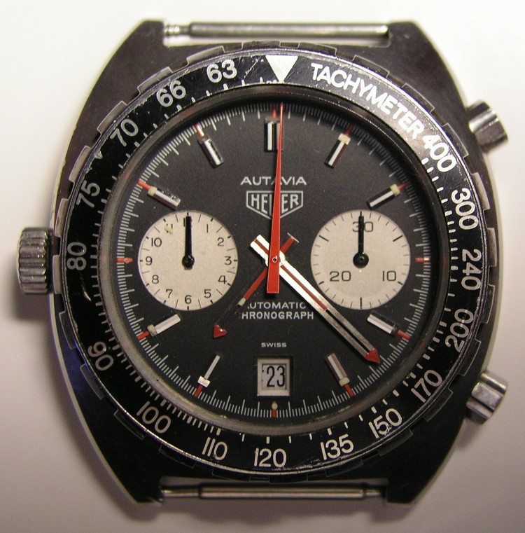

Dial is not from 1163V, from typo it's a very late dial taken from a 11063T.
If you want to replace the 'natural' configuration you should swap the case with a 11063 one!
Finding correct dial + movement + handset for that early 1163 case is hard matter...
