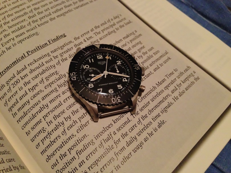

Here on an extract from the LRDG manual, giving interesting background on the same navigational technique:
