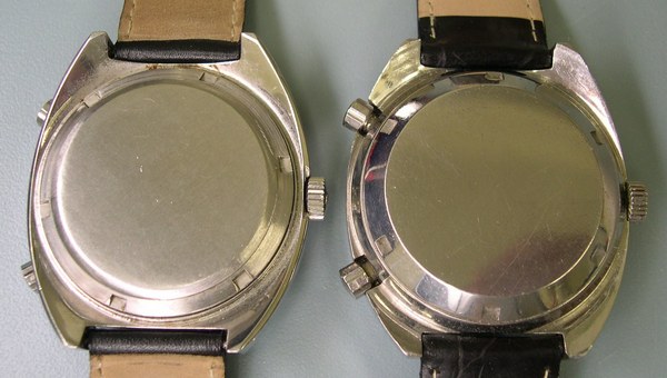

Reference 1163V (left) and Reference 11630 (right)
Reference 1163V (earlier)
Reference 11630 (later)
- Inner Bezel
(between dial and crystal)
polished steel (shiny) |
black (matte)
- Crystal
plastic (domed)
mineral (flat)

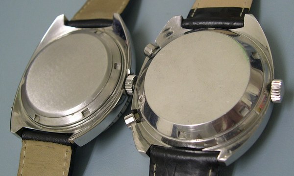

- Case-Back
shallow
deep, with sides at 45 degrees

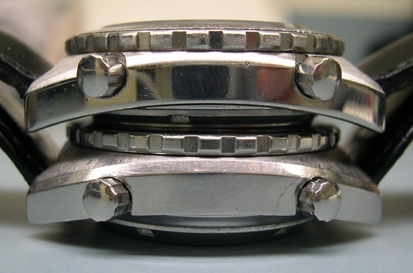

- Pushers
- fully visible from front
- partially obstructed from back
fully visible from back
partially obstructed from front
- Thickness
(top of bezel to back of case)
13.0 mm
14.6 mm
