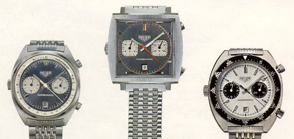

: Screenprinting techiques of the 70is: different logo and
: productname position on different dials, reason ?
: Different typos across A, C, M ?
That one's hard to tell. They showed prototypes at various shows building up to series production, but as Paolo stated in one of his replies, a number of each model was shown at each show, even as early as Basel in April. So there's no rhyme and reason to why the models should differ at all. But if we look at the press release announcing these in March 1969, we see something perhaps unexpected in the dials:
Yep. No model names at all, even though the other details are pretty much as per the final product. So we can assume that the dial designs were in flux during the process. Perhaps the designs were fixed at different times, which is about the only reason I can think of why the 1163 T should differ from the MH as much as it does. Though the printing has an impact on that too, we'll get to that next.
