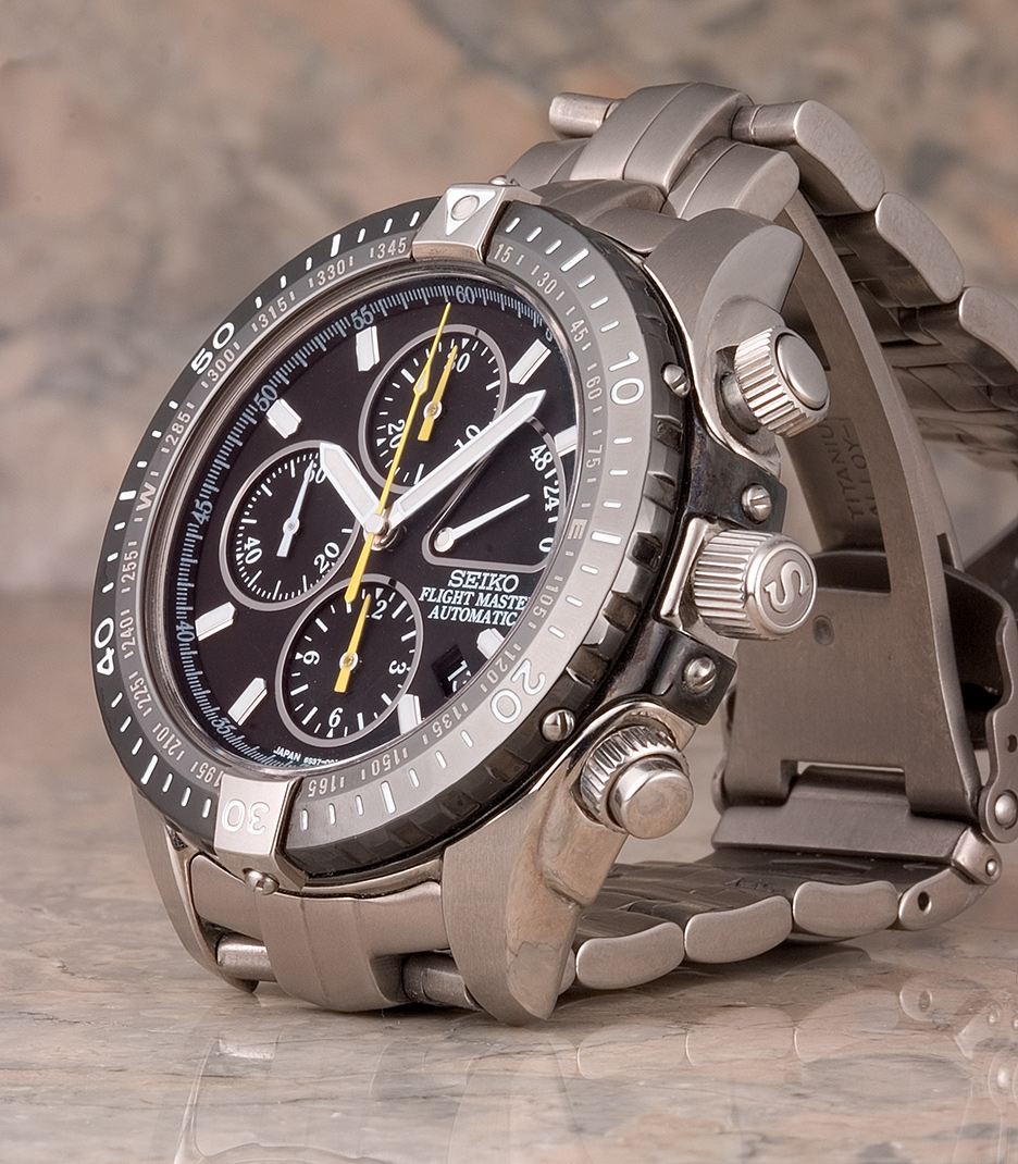

: For anyone who might be asking the question, "So what are the
: Seikos that use this movement?", have a look here at their
: amazing Flightmaster . I've got to think that TAG-Heuer will do
: just fine with its new movement!!
: Bravo, to the home team; well done, Jean-Christophe!!
